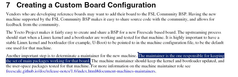

igorpadykov
HI Kishore
I think this should be addressed to maintainer of this board, please look below
at part of Freescale_Yocto_Project_User's_Guide.pdf 12
Board maintainers are working on meta-fsl-arm mailing list, so
you can post it on
https://lists.yoctoproject.org/listinfo/meta-freescale
