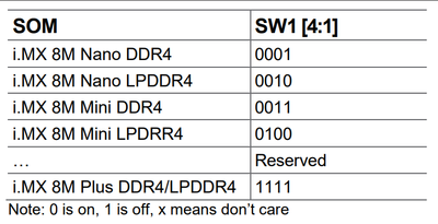

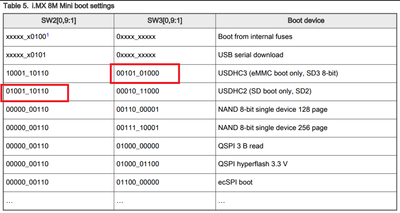

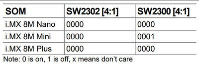

Ok, some of your switch configurations are wrong if you are trying to boot with an iMX8M mini, please check attached images to use the correct one:
Note: 0 is off, 1 is on, x means don’t care (you are using the marked switch configurations).
CPLD Mode:
ID switches:
