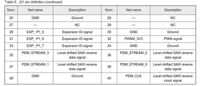

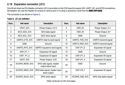

j21 connector has 40 pins below are the pin details
i am trying to use pwm4_3v3 which is 32 pin on j21 connector .
