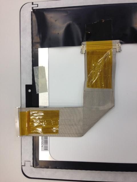

Hello there,
What is the part name/part number of FPC (Interface cable -30PIN ) used in SABRE board  to connect LVDS1 and Display panel?.
FYI please find the attachment image reference of the cable on IMG_5859.JPG                                                                                                                                                                                                                                                                                     SABRE board.
Pole
1,950 Views
Rita_Wang
Hi Pole,
The connector is DF19G-30P-1H(56), Manufacturer: HIROSE. In the hardware you can refer to our SPF-27392_C3.pdf design file. And the link for the connector is as follows:
