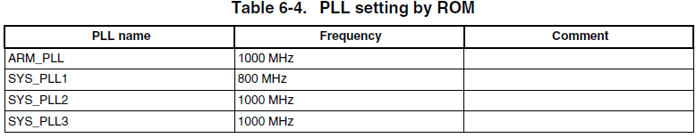

What is the maximum frequency of i.MX8M Mini flexspi?

Hi Mike
max. frequency can be found in sect.3.9.10 FlexSPI timing parameters
i.MX 8M Mini Applications Processor Datasheet for Consumer Products
