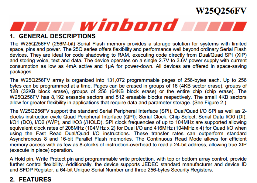

  On imx6 solo,My board boot from spi nor flash 32MB in standard or dual operation and solo not support quad spi.
  what the max. clk freq. of solo to boot from spi nor flash? Is it 60MHZ?And the flash is 104MHZ or 208MHZ for standard or dual spi.So,solo's spi clk is lower to spi nor flash?Pity.
  My flash isW25Q256FVEIG,winbond 32MBYTE SPI NOR FLASH.

  please look at the following Q&A: What is i.Mx6 ECSPI max frequency?

From your link,It is only 60mhz for spi nor flash clk.
Thanks.
