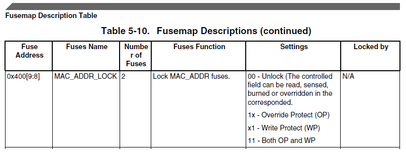

What is the different for eFuse MAC_ADDR_LOCK (OP/WP)?

As title.

Yuri
Usually one may use the fuse override feature to test applications,
which read fuses, but not for boot. The override fuse values will be lost
upon reset, since the values are stored in registers.
