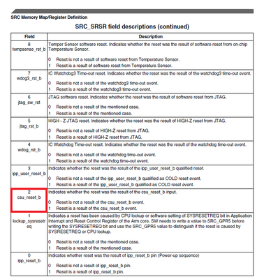

I can find no explanation for what the csu_reset_b input, bit or event is in the SRC SRSR status register. Can someone point me to NXP info for this bit?
Thanks!!

Regarding your question, the Chip Security Unit is appears there because it is a software reset that can be registered on this register to know when a SW reset was occurred by DMA. You may check for example RT1010 Reference Manual and see chapter about CSU to know about it. And as you may know, the SRC?SRSR is just a register that saves a 1 logic when mcu was reset by some of the shown modules just to have a reference or control.
Hope it helps!
