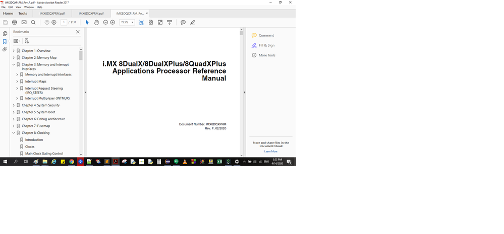

I couldn't found the GIC Base_ Address in the Memory Map chapter. so Is that mean that any peripheral that it's base address is missing from the memory map chapter is controlled by the SCU unit or else?

Hi Igor
The RM you use is for i.MX 8QuadMax but I'm using i.MX 8QuadX
trm.pngso I think the GIC base address must be written in the RM for the chip I use not in another chip in the family.

helmy_mohamed
Hi Igor
I can't found the base address for the GIC in the Table that you've mentioned. I've looked up the TRM table 2 - 18 didn't found anything.table2-18.png
Also nothing in the DB memory map regarding the Address you've sent.
Also If there is any peripherals with missing Base_Addresses in the TRM should I Assume that it's controlled by the SCU unit

igorpadykov
Hi Helmy
it is assumed that SCFW APIs are used only for configuring
interrupts, so GIC address is not provided in Reference Manual.

igorpadykov
Hi Helmy
GIC address is 51A0_0000 according to Table 2-18. Dblog memory map
i.MX8QM Reference Manual (one can obtain it in local marketing office).
Yes it is controlled by the SCU and described in
sect.13.1 (SVC) Interrupt Service sc_fw_api_qm_b0.pdf included
in SCFW Porting Kit
