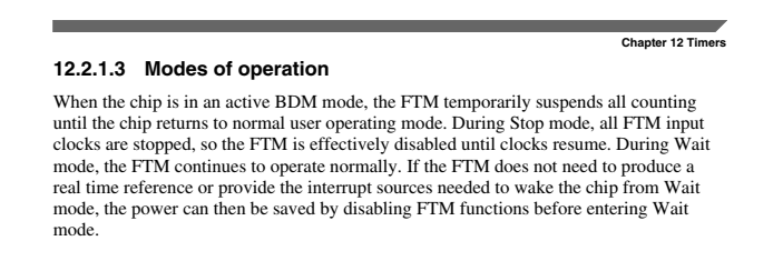

Hi, I was going through the FlexTimer module in the iMX7 reference manual and there is a mention of BDM mode. What is this mode?

Hi Deepak,
BDM = Background Debug Module.
