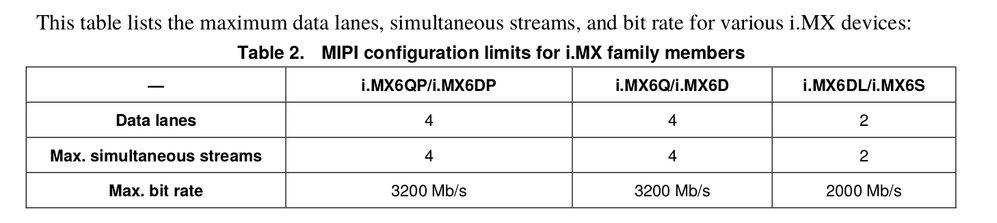

Hi All,
What is i.MX8Mmini MIPI-CSI2 Max. bit rate ?
In i.MX6 CPU it is very clear  Total is 3.2GBit/s

Hi Danube ,
You can refer section 13.1.1.1 Display Interface from i.MX8Mmini Applications Processor Reference Manual for Bit rate of MIPI CSI2.
