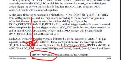

Hello Team
I have a quick question, what is back-to-back mode?

  Now, answer your questions, please read the RM next to your picture, you will find it is clear to understand about the B2B mode:
So, the B2B function is minimize the trigger time, it will trigger will happen immediately after the ADC conversion, if no B2B, the next trigger will have delay. About the detail settings, you can check the ETC_TRIG Chain Register, B2B bit
