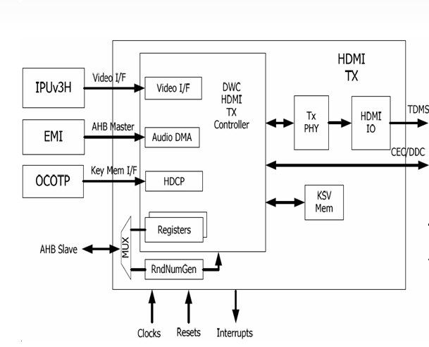

Hi community,
Our partner have a question about i.MX6 HDMI.
You know HDMI display refresh rate are several.
(e.g. 60.00, 59.94, 50.00, 23,98 Hz, etc...)
Then, what register determin the refresh rate?
HDMI module does not control and IPU DI controls it by VSYNC?

Hi Satoshi
yes IPU controls it by VSYNC, providing data to HDMI,
one can look at example in IMX6DQRM Figure 33-4 and appnote below
shows how refresh is defined in LInux:
AN3974 Different Display Configurations on i.MX35 Linux PDK
sect.3.3.1.2 Panel Configuration, refresh rate
igor
