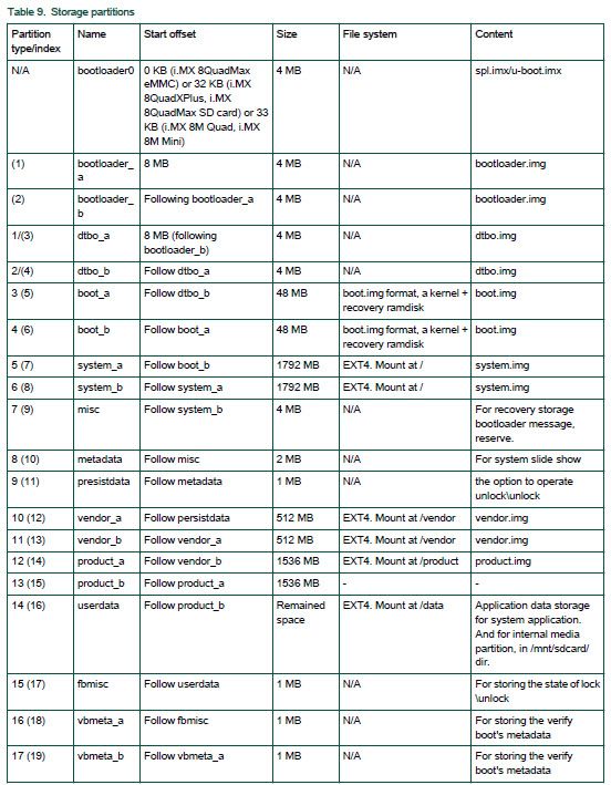

diegoadrian
All the information regarding the storage partitions. It can be found in the Android_User's_Guide, there is a table where it specifies the size of every needed partition.
Hope this information may be useful to you.
Diego.
