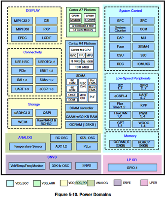

Chavira
Hi @takayuki_ishii!
The GPC_PGC_MIX_CTRL should be PGC for fastmix/megamix and according to the diagram below.
Best Regards!
Chavira
