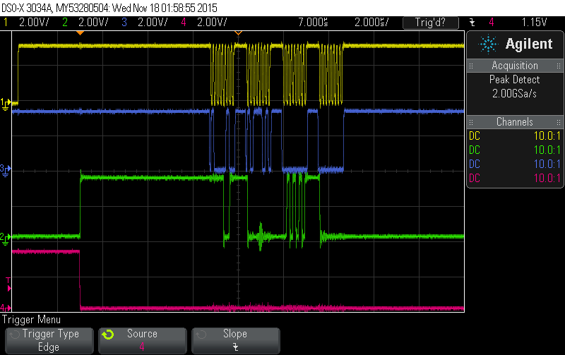

Here is an image of what a normal SPI packet looks like: The iMx6 is the SPI master. Yellow is SPI Clock, Blue is MOSI, Green is MISO, Pink is SPI Chip Select

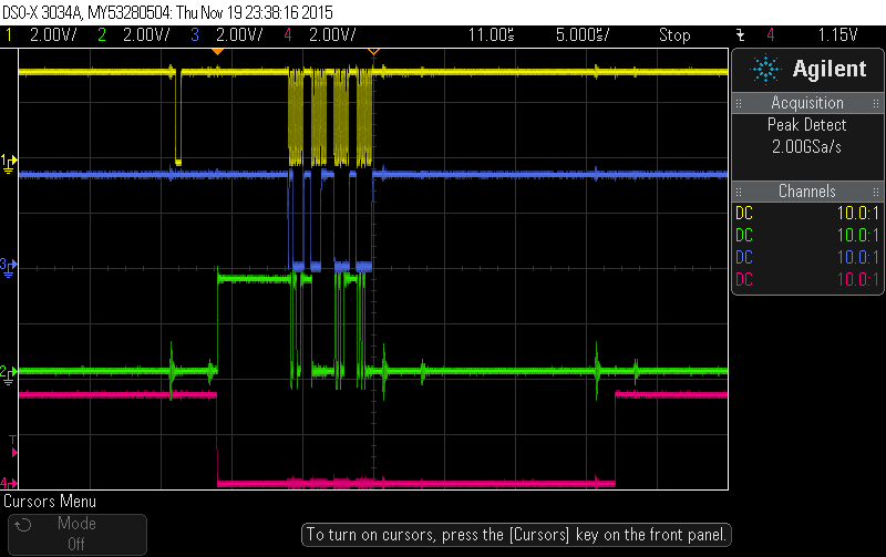

Below is the image of when the iMx6 Linux SPI driver dies: I'm triggering on the Ship Select going low(active).
When the SPI driver dies, the Chip Select stays active low forever. And all other SPI activity with that clock halts.
There are three slave devices sharing this clock. Only when a slave SPI device is plugged into the Chip select pin (EIM_D24) and another is plugged into the Chip Select pin (DISP0_DAT15) does this SPI driver crash issue occur.
