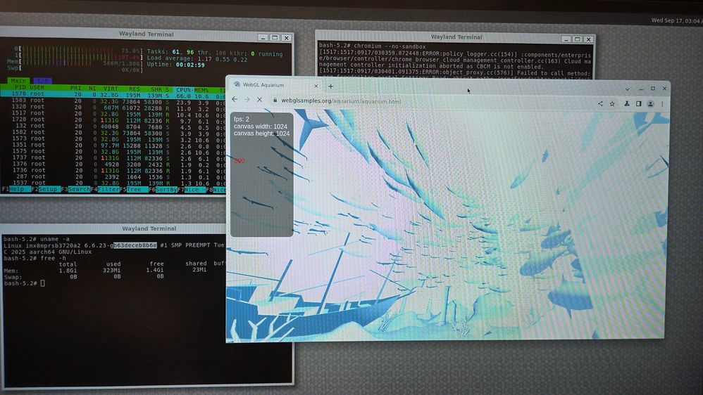

We are experiencing crashes with Chromium on the i.MX 8M Plus (i.MX8MP) with 2GB of RAM running Yocto 5.0.
result:
2G RAM FAIL
6G RAM Pass.
Do you have any idea for fixed the issue?

  7. Test command:
    1. chromium –no-sandbox

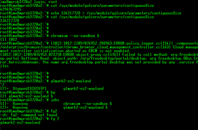

pengyong_zhang
Hi @charleshuang
Try to use below command,
echo 134217728 > /sys/module/galcore/parameters/contiguousSize
Because i have no 2GB DDR on my site, so i can not reproduce your request. you need to try it on your board.
B.R

charleshuang
Senior Contributor II
Hi @pengyong_zhang
Still fail. (system crash)

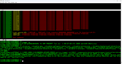

Jems-advantech

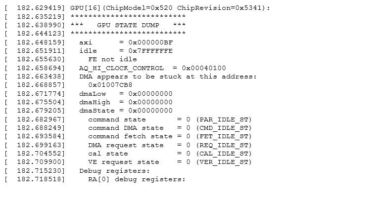

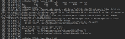

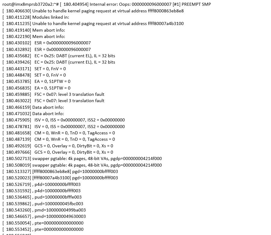

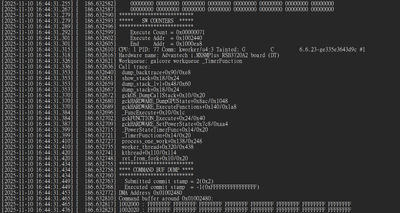

Thank you for providing the test command. I have executed the test as suggested, but unfortunately, the Chromium browser still hangs and eventually crashes. After the crash, the desktop becomes completely unusable; however, the debug console remains operational.
Here is the running information:
The memory size remains around 1.4 GB, but some error messages appear.
After the desktop crash, I executed dmesg in the debug console, and additional error messages were observed.
Attached is the full log for your reference.
Kindly let me know if there are any additional steps or alternative approaches you would recommend.
