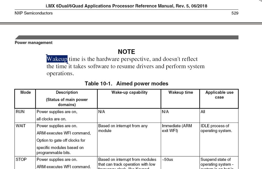

I am using the Nitrogen6_MAX equipped with the i.MX6 Quad-Core ARM Cortex-A9 processor which works with the Linux 4.14.0 kernel. According to Linux documentation, the wake-up time for supend-to-s2idle is less than the wake-up time for Suspend-to-RAM. But I measured these wake-up times with Oszilloscop and I noticed that the wake-up time of supend-to-s2idle is greater than the wake-up time for Suspend_to_RAM. Can someone please explain this to me?

Hi Mouako
wake time additionally depends on used software, as described below
since Nitrogen6_MAX board and its software was developed by boundary devices, issue
may be posted on its support: https://boundarydevices.com/wiki-bd/
