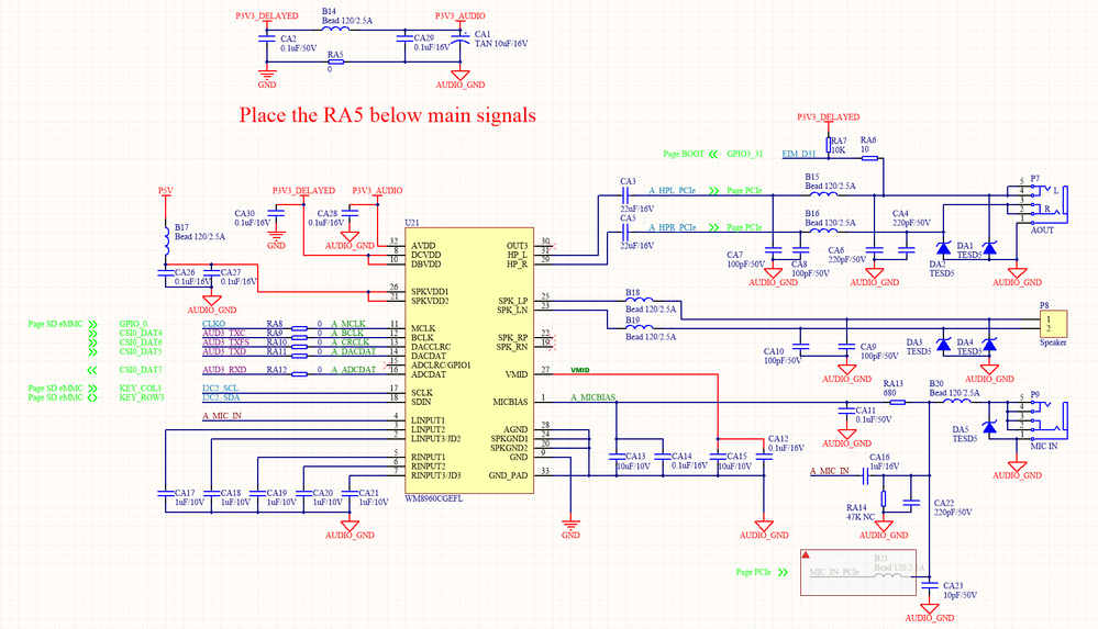

Hi Huang,
    Thank you for your reply!
    I think the hardware is ok, because I have check the oscilloscope, it works well with 24MHz, and the audio port from imx6q could output signal as well. In the other hand, Android 4.4.3 with 3.10.35 kernel version has sound on the same board. But the two driver codes are quite different.
    Maybe our wm8960 hardware design is not suitable for the new driver. hehe.wm8960.png
        I don't know wthether it could be the problem.
Thank you
Carit

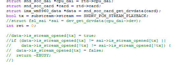

kcy15
I was just porting the wm8960 on android6.01 (Linux 4.1.15), and modify the driver just like what you show. and modify  this .
The clock is normal output, but 8960 output 1.41 M, can't hear any sound, please help me to see what's the problem

//struct fsl_sai *sai = dev_get_drvdata(cpu_dai->dev);
int ret = 0;
//data->is_stream_opened[tx] = true;
//if (data->is_stream_opened[tx] != sai->is_stream_opened[tx] ||
// data->is_stream_opened[!tx] != sai->is_stream_opened[!tx]) {
// data->is_stream_opened[tx] = false;
// return -EBUSY;
if (!data->is_codec_master) {
