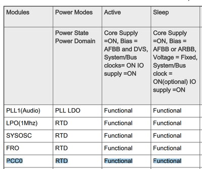

Bio_TICFSL
Yes, it should be possible according to Reference Manual, look at chapter 9.1.7 Power mode details (real-time domain):
As you can see all the necessary components to WDOG0 are available during ARBB mode, but maybe there is the possibility that uPower is gating clock of this WDOG or maybe of entire PBRIDGE0.
Please take a look to the uPower Firmware User's Guide.
