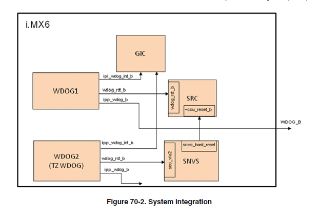

Hi Sir,
My customer question is why reboot command will cause WDG_B assertion and why CPU will hang if we do NOT connect WDG_B to system reset?
If we set reboot command in Linux 3.14, we can observe that imx6 watch dog WDG_B will assert.
If we do not connect WDG_B output to CPU POR_B reset input pin, then the CPU will hang , but We found Linux 3.0.35 is OK(not hang)
Does it mean the WDG_B “must” connect to system reset to reset whole system even if we do not need watchdog feature?

I would like to know which wdog is currently used? WDOG1 or WDOG2.
Currenty, the BSP L3.14.28 is using WDOG2, which is in the TZ.
And only way for WDOG2 without enable TZ is to toggle the WDOG_B for POR_B.
That is the i.MX6 SDB board hardware design.
But the WDOG1 is not in the TZ, the wdog_rst_b is connected to the SRC directly.
If you change the device tree to use wdog1, you will find differenct reboot reason in uboot.
Related the source code in the system.c which give chance to add the delay or the other operations before system can prepare to reboot. This depends on your system design.
So the BSP need to do some customization to system.c.
That is why you said in uboot reset is fine.
you need to stop something before reboot.
and the reboot in uboot is wdog reboot.
WDOG_B is better to give outsite a signal, the WDOG is to do reboot even using wdog1.
The typical use case is to reset the pmic to get the intialized status.
Next time, please report issue in detail, not just say hang someting, no any valuable information can help you to check issue.

WDOG reset by wdog1:
In Linux:
/unit_tests/memtool -16 0x20bc000=0x34
or modify the device tree to switch to use wdog1 and type reboot command line
imx6q-sabresd.dts
59 &gpc {
60     fsl,wdog-reset = <1>;
61 };

igorpadykov
Hi JIMMY
for reliable reset wdog should reset whole board, as it is
done on Sabre schematic spf-27392 p.19, U507 p.21 with
signal  PMIC PWRON.
CPU will hang if was reset from low power mode with lower
VDD_ARM, SOC voltages than needed for start-up.
igor
