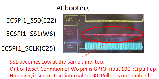

In our system, two Flashs are connected to SS0 and SS1 of ECSPI1 port.
And ECSPI Boot from SS0 is used.
We have a problem that boot fail occurs infrequently.
W6 pin is used as ECSPI1_SS1.
This W6 pin is GPIO Input 100K pull-up by default.
We checked SS pins of ECSPI.
We found that SS1 became Low at SS0 assertion.
We think that internal Pull-up is not enabled.
Is the description of the data sheet right?
Is there the method that this pin sets to the High(Pull-up) during ECSPI Boot?

As the i.MX6Solo Data Sheet document says, actually, this pin is configured as GPIO input with 100kOhm internal pull-up enabled at out-of-reset state. Isn't there any other external load on this pin? What happens if pulling the pin up with an external resistor? Please check.

The W6 pin is directly connected only in CS of serial Flash.
This signal line does not be pull-downed externally.
If CS of serial Flash be pull-downed internally, may it make this signal line Low?
When this line is pulled-up externally, it seems that boot fail does not occur.
Do we need outside pull-up to avoid the W6 pin becoming Low?
We cannot add outside Pull-up because development has been already completed.
Is there any good method for this situation?

This problem was our setting mistake.
We found W6pin having been set in Hi-z in U-Boot.
