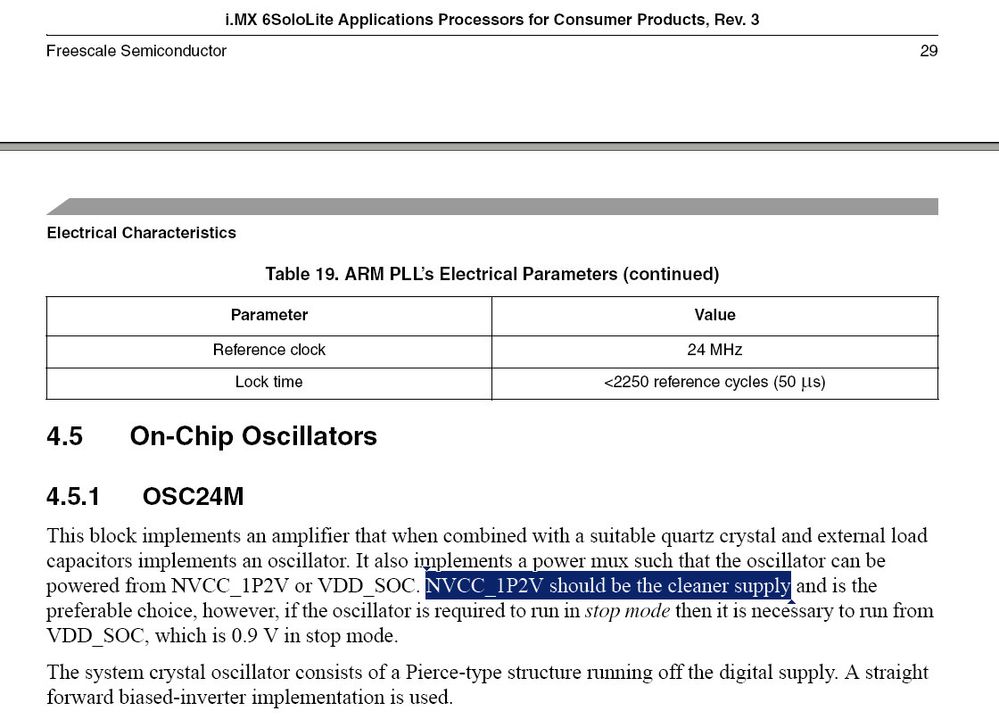

I'm using i.MX6SL and PF0100 and have question about voltage supply when I use DDR3.
Can MMPF0100F4AEP supply both NVCC_1P2V and NVCC_DRAM ?
According to the EVK's schematic, NVCC_1P2V and NVCC_DRAM are supplied from different LDO.
NVCC_1P2V is VGEN1 and NVCC_DRAM is SW3A/B.
However, MMPF0100F4AEP has only one 1.5V output.
So I plan to supply both NVCC_1P2V and NVCC_DRAM from SW3A/B.
Do I need to supply voltage separately ?

Hi Ko-hey
recommended to power it from separate clean LDO as it is used by
oscillator circuit as described in datasheet
igor

Thank you for your reply.
So NXP recommend to add external LDO for supplying 1.5V to NVCC_1P2V.
Is it correct ?

Hi Ko-hey
yes correct.

I understand that NXP recommend to supply voltage to NVCC_1P2V separately.
Let me confirm about supplying NVCC_1P2V again.
Does NVCC_1P2V have to supply voltage before POR_B is asserted ?
MMPF0100F4AEP has LDO that isn't programed such as VGEN2.
If I can supply voltage to NVCC_1P2V after POR_B is asserted, I want to use those LDOs.
I would rather not add a external LDO as much as possible.
So please advise me.

I found following Community.
https://community.freescale.com/message/405181#comment-405181
As far as I checked the community, it have to be supplied voltage to NVCC_1P2V separately.
Thank you for your corporation.
