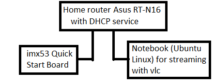

Hi, I want to play multicast video stream on the imx53 Quick Start Board (Ubuntu 10.04 L2.6.35_11.09.01). But the device can not play it correctly for reasons unknown to me. My network scheme is following:494-NetworkScheme.png
To play a multicast video on the device, I did the following:
1) Network buffer of the device was increased and IGMP setted to v2
echo 204800 > /proc/sys/net/core/rmem_max
echo 2 > /proc/sys/net/ipv4/conf/all/force_igmp_version
echo 2 > /proc/sys/net/ipv4/conf/default/force_igmp_version
2) imx53 Quick Start Board getting network settings from DHCP service.
3) for playing udp stream to network I used notebook with VLC player running. To run VLC I made the following:
a) Tools->Preferences(Show settings - switch to all)->Stream Output->Access Output. Set "Multicast output interface" and "IPv4 multicast output interface address" to my ip address of notebook network interface.
b) We can play video using next steps. Open "Media" menu, next "Streaming", add video file to list, press button "Stream", press button "Next" on the new opened dialog, select "New destination" to UDP (legacy), press button "Add", set address to 239.0.0.1 and port to 1234, uncheck "Activate transcoding", then press "Stream" button to start streaming video.
4) On the device I try to use the following commands:
gst-launch udpsrc multicast-group=239.0.0.1 auto-multicast=true port=1234 buffer-size=1000000 ! decodebin2 use-buffering=true max-size-buffers=32 max-size-bytes=1000000 ! mfw_v4lsink
gst-launch udpsrc multicast-group=239.0.0.1 auto-multicast=true port=1234 ! decodebin2 ! mfw_v4lsink

My PC network settings:
netspider@netspider-nb:~$ ifconfig
eth0 Link encap:Ethernet HWaddr 00:24:54:87:3d:36
inet addr:192.168.1.103 Bcast:192.168.1.255 Mask:255.255.255.0
inet6 addr: fe80::224:54ff:fe87:3d36/64 Scope:Link
UP BROADCAST RUNNING MULTICAST MTU:1500 Metric:1
RX packets:620 errors:0 dropped:0 overruns:0 frame:0
TX packets:4156 errors:0 dropped:0 overruns:0 carrier:0
collisions:0 txqueuelen:1000
RX bytes:896845 (896.8 KB) TX bytes:5098576 (5.0 MB)
Interrupt:19
lo Link encap:Local Loopback
inet addr:127.0.0.1 Mask:255.0.0.0
inet6 addr: ::1/128 Scope:Host
UP LOOPBACK RUNNING MTU:16436 Metric:1
RX packets:0 errors:0 dropped:0 overruns:0 frame:0
TX packets:0 errors:0 dropped:0 overruns:0 carrier:0
collisions:0 txqueuelen:0
RX bytes:0 (0.0 B) TX bytes:0 (0.0 B)
netspider@netspider-nb:~$ route
Kernel IP routing table
Destination Gateway Genmask Flags Metric Ref Use Iface
default phoenix 0.0.0.0 UG 0 0 0 eth0
link-local * 255.255.0.0 U 1000 0 0 eth0
192.168.1.0 * 255.255.255.0 U 1 0 0 eth0
For streaming on the network interface eth0 (maybe you have another interface name?) just run command like this:
netspider@netspider-nb:~$ sudo tcpreplay -i eth0 /mnt/d/10/fashiontv_77.cap
[sudo] password for netspider:
sending out eth0
processing file: /mnt/d/10/fashiontv_77.cap
^C
Actual: 6495 packets (8820210 bytes) sent in 9.43 seconds
Rated: 935335.1 bps, 7.14 Mbps, 688.76 pps
Network settings on the client:
lucid@lucid-desktop:~$ ifconfig
eth13 Link encap:Ethernet HWaddr 00:04:9f:01:c9:28
inet addr:192.168.1.105 Bcast:192.168.1.255 Mask:255.255.255.0
RX packets:165 errors:0 dropped:0 overruns:0 frame:0
TX packets:119 errors:0 dropped:0 overruns:0 carrier:0
RX bytes:16434 (16.4 KB) TX bytes:14694 (14.6 KB)
Base address:0x6000
RX packets:108 errors:0 dropped:0 overruns:0 frame:0
TX packets:108 errors:0 dropped:0 overruns:0 carrier:0
RX bytes:5560 (5.5 KB) TX bytes:5560 (5.5 KB)
lucid@lucid-desktop:~$ route
192.168.1.0 * 255.255.255.0 U 1 0 0 eth13
link-local * 255.255.0.0 U 1000 0 0 eth13
default phoenix 0.0.0.0 UG 0 0 0 eth13
I think next problems can take place in this case:
1) tcpreplay command not installed on the host
sudo apt-get install tcpreplay
2) Problems with routes on the host or client. You could use this command on client and pc:
route add -p 239.0.0.0 mask 255.0.0.0 dev eth0
3) Network interface configured without multicast support.
I hope this helps you.
