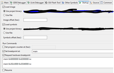

I am facing problems with debugging code using J-link and VSCode extension with iMXRT117x. I am using a custom board without flash - only external RAM is available. With MCUXpresso I was able to establish proper debugging session but with VSCode I have troubles.
First thing that is not working fully correct for me is that J-link settings file is loaded from default location which is in the "build" directory. I can change the settings in the file but my environment work in the way that when I clean project the build directory is deleted so I need to change settings file every time I clean the build. Is it possible to set custom path to the settings J-link file?
Second thing is that to be able properly debug the code I need to add the memory settings. In the MCUXpresso it is done in the way presented below
How can I add this settings to the VSCode debugger?

Hi @Greenhal,
Unfortunately, the two features that you are looking for are not available on the current version of VS Code. Please continue using standalone MCUXpresso IDE instead.

Hello!
You're facing two key issues with J-Link and VSCode on your iMXRT117x custom board. First, to avoid losing your J-Link settings file when cleaning the build directory, you can set a custom path in launch.json using the -settingsfile argument, pointing to a stable location like ${workspaceFolder}/jlink_settings.ini. Second, to enable proper debugging with external RAM, replicate MCUXpresso’s memory settings by adding a memoryMap entry in launch.json, specifying the RAM’s start address, size, and access type. This ensures the debugger knows where valid memory is for breakpoints and variable inspection.
