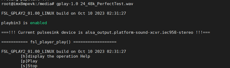

where do you need get audio? I tested gstreamer command as below, and can get audio from headphone,
when use gplay-1.0, get the message as below, which means gplay uses imxaudioxcvr codec, this codec isn't  supported by current gstreamer, so I use another command to replace

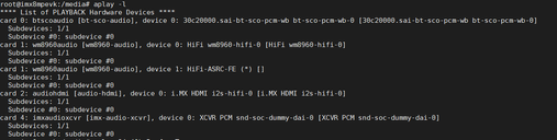

firstly you need use aplay -l to check all of codecs current bsp support
then I used command to test by wm8960 codec as below
gst-launch-1.0 playbin uri=file:///media/24_48k_PerfectTest.wav audio-sink="alsasink device=hw:1,0"
