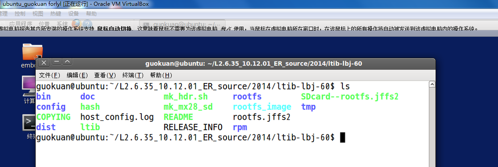

 want to use yaffs2  for  root filesystem,kernel configure for yaffs2 (Miscellaneous filesystems.png,Boot options.png) ,ltib -m config for yaffs2 (ltib config option.png).
I run  nandwrite -p  /dev/mtd1 /mnt/sdcard/rootfs.yaffs2 command down the yaffs2 filesystem to the nandflash, when start the freescale  imx287 board .  I eagerly  look forward to help.   the follow error appear:
VFS: Mounted root (yaffs2 filesystem) on device 31:1.
Freeing init memory: 160K
------------/sbin/init------------
Kernel panic - not syncing: No init found. Try passing init= option to kernel. See Linux Documentation/init.txt for guidance.

@Victor Linnik     yaffs2 filesystem  was created by busybox1.20 .  ltib automatic generated rootfs , through “mkyaffs2image“  tool  generate yaffs2 filesystem error is same.ltib automatic  generate rootfs .png

Please make sure that right filesystem is mounted as rootfs.
Victor
