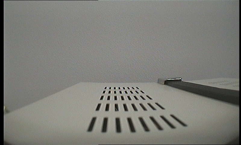

We are trying to use two TVP5150 decoders on our custom board connected to CSI0-IPU0 and CSI1-IPU1 respectively. Source signal for both decoders comes from two PAL cameras. The CSI0-IPU0 works good, tested with tvin and overlay unit tests (though I had to manually set input height to 576 to get proper vsync in overlay test). Below is a screenshot from running overlay unit test on CSI0-IPU0 path from first TVP5150:
As you can see the image is ok, apart from some horizontal and vertical blank pixels .

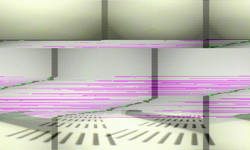

Using the same driver we tried to test CSI1-IPU1 path, and this is the result:
The capture is both not hsynced and vsynced (scrolling in both axes). There are also some green and purple lines showing up. To be sure that secondary TVP5150 output signal is correct we disabled first decoder chip from CSI0-IPU0 path and connected digital outputs from CSI1-IPU1 path decoder to CSI0-IPU0 inputs and image was OK (like on first screenshot). Since we are using BT.656 mode in decoder/mxc_v4l2_capture we can assume pins are muxed correctly (since IPU detects EAV nad SAV properly). This leads me to believe problem must be on mxc_v4l2_capture or IPU driver side.

I tried switching around CSI_MEM channels in ipu_csi_enc.c for secondary csi/ipu pair but still same effect. I tried CSI -> IC -> MEM path and it seems to have proper hsync but still not vsynced and green/purple lines still do appear. Problem still is not solved.
By the way: Those green lines appear even if I switch off camera input to the decoder. At this point I am not sure if those are artifacts introduced by IPU or is it something overwriting the double-buffer memory.

The purple and green color noise is often a sign of a noisy pixel clock especially when it starts and stops in mid line as your test image shows. I've seen very similar distortion when we had a signal integrity problem on a board that caused a non-monoticity on the pixel clock line. The non-monoticity sometimes looked like an extra clock edge to the CSI and so it clocked the same sample in twice. BT.656 data arrives as interleaved YUV422 which is a luminance sample follow by either an R or B chrominance sample (YUYVYUYV....). The extra false clock caused two problems: 1) synchronization was lost because the row is shifted over  2) the luminance and chrominance channels become swapped (causing the purple lines which end in green). The next time a false clock occurs the extra sample fixes the luminance/chrominance swap and you can see this in some of the lines where the purple starts and then stops.
In our case, when I used regular oscilloscope probe to examine the pixel clock, the capacitance of the probe (about 13 pF) was enough to filter out the non-monoticity and the image cleared up as soon as I touched the probe to the clock line. Using an acitve (low capacitance probe) I was able to see non-monoticity that was messing up the image. We were able to fix the signal integrity issue on the next board layout by adding some termination.
The other thing that may cause this type of noise is pixel clock polarity (check the SENS_PIX_CLK_POL for CSI1). Clocking the sample in on the wrong clock edge can cause sync problems because the SAV/EAV codes may be corrupt. It could also cause color noise if the data lines from the previous sample have not settled.
Finally, I noticed that the test image you posted has interlacing noise (the light/dark combing effect) and the two fields are not combined. Your PAL camera will produce interlaced video which the TVP5150 will send over the BT.656 link as Field0 followed by Field1. It looks as though the de-interlacer (VDIC) is not in the path for CSI1-IPU1.

Pixel clock seems to be alright (it was also tested before when we cross-connected decoders to different CSI-IPU inputs). Nothing unusual found using the o-scope.
I tried changing clock polarity and odd thing is that changing it had no visible results even when done for CSI0/IPU0. With inverted clock polarity CSI0/IPU0 image was still good and CSI1/IPU1 still distorted.
Regarding video being interlaced - you are right. It seems default CSI -> MEM path for CSI1/IPU1 has no deinterlacing done. I forgot to mention this earlier but using CSI -> IC -> MEM path for CSI1/IPU1 gives deinterlaced video and good hsync (but still same green/purple distortions are present in the image).
One additional note is that those green lines (which become purple when picture in the background is closer to white than to black) appear on the whole screen (not just the middle) and they seem to be scrolling from top to bottom of the screen. Even if I force TVP5150 to output black screen (value 0x08 in register 0x00) those green lines are still scrolling in the image.
To sum it up it seems that CSI1-IPU1 receives correct, undistorted signal and distortion happens somewhere on the ipu hw/driver level.

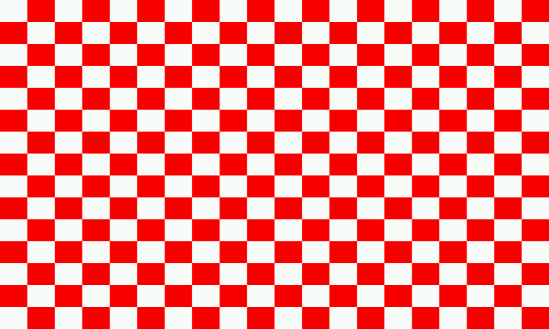

Running IPU and in particular IPU_CSI register dumps gives no evidence of faulty configuration (apart from CSI0_ACT_FRM_SIZE being set for IPU1 while remaining CSI0 registers are 0 as they should be, this does not happen for IPU0 - the CSI1_ACT_FRM_SIZE in that case is 0).
I made the  chessboard test for both IPU0 and IPU1 and results were interesting: in both cases chessboard is stable and displays correct colors for even squares... but for odd squares they are white instead of black (as is specified in the reference manual). When I set the test generator to output R=0xFF G=0xFF B=0xFF even fields are white as expected (and black for 0x00). Right now I do not understand this behavior, if this was error in the SW then even fields would not display white when FFs were set for all RGB values. Error in documentation I guess? Or some misunderstanding on my side. You can see the result in the screenshot below:
So to sum it up, chessboard test passes for both IPU0 and IPU1 (apart from white fields). Register dump from tests with TVP5150 decoder (not a chessboard test dump) included as files, maybe this will help. Interesting thing is that even for dump2.txt where secondary IPU was tested at some point there were logs from IPU0 (I mean those dma related messages). Our framebuffer device is using IPU1 if this is any help to the case.
