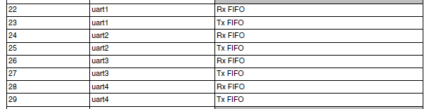

I don't understand why in examples for mx8mm the sdma channel request was offset by 2 unlike the Applications Processors Reference Manual (7.1.4 SDMA event mapping) for escpi and uart, or did I miss something? I tried to use the value in datasheet but the SDMA_GetErrorStatus returns the ecspi TX dma channel (not the channel request).
#define RTE_SPI1_DMA_TX_CH_REQUEST (3U)
#define RTE_SPI1_DMA_RX_CH_REQUEST (2U)
or for uart 3:
#define DEMO_UART UART3
#define UART_RX_DMA_REQUEST (28)
#define UART_TX_DMA_REQUEST (29)
