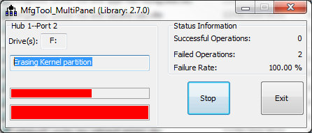

We design SOMDIM board based on i.MX6UltraLite.
We populate NAND region as described on How-To use NAND boot on i.MX6UL EVK board .
I'm using L4.1.15_2.0.0-ga mfg-tools.tar but I can't identify where I need to change to burn the Nand Memory.
I tried to change "cfg.ini" but the program got errors. See below:
"Boot" body="BootStrap" error, file="C:\L4.1.15_2.0.0-ga_mfg-tools.tar\L4.1.15_2.0.0-ga_mfg-tools\mfgtools-with-rootfs\mfgtools\Profiles\Linux\OS Firmware\firmware\u-boot-imx6ul14x14ddr3arm2_emmc.imx"
"Boot" body="BootStrap" error, file="C:\L4.1.15_2.0.0-ga_mfg-tools.tar\L4.1.15_2.0.0-ga_mfg-tools\mfgtools-with-rootfs\mfgtools\Profiles\Linux\OS Firmware\firmware\u-boot-imx6ul14x14ddr3arm2_sd.imx"
Previously I used  an sd card with an linux image to test all the other peripherals and the board is work perfectly.
I need to test the Nand interface to finish my job.
See attached my board's image
Does anybody can help me?

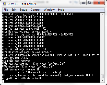

igorpadykov
Hi Bruno
except building uboot for L4.1.15_2.0.0 (this is uboot-imx-imx_v2016.03_4.1.15_2.0.0_ga)
as described in step 1 mentioned link, it is necessary to rebuild linux, including gpmi driver, refer to
Chapter 33 NAND GPMI Flash Driver attached Linux Manual. Rebuild Mfg Tools firmware,
refer to sect.6.2 Manufacturing Tool, MFGTool Yocto Guide. New files replace in mfg tools ..OS Firmware/firmware folder.
When booting, use "mtdparts" kernel command parameter as described in Release Notes, Linux Guide.
No need to to change "cfg.ini", as clicking on *.vbs script mfg tool starts and automatically takes necessary parameters from script.

brunoferrarezi
Hi Igor,
Thank you for your explanation.
Now I'm using MFGTOOLS using "mfgtool2-yocto-mx-evk-nand.vbs".
I don't know what is wrong now. See below.
See below the terminal log:
The
Full log:

UTP: received command '$ mount -t debugfs debugfs /sys/kernel/debug'
UTP: executing "mount -t debugfs debugfs /sys/kernel/debug"
UTP: sending Success to kernel for command $ mount -t debugfs debugfs /sys/kernel/debug.
utp_poll: pass returned.
UTP: received command '$ flash_erase /dev/mtd0 0 0'
UTP: executing "flash_erase /dev/mtd0 0 0"
Erasing 128 Kibyte @ b40000 -- random: nonblocking pool is initialized
Erasing 128 Kibyte @ fc60000 -- utp_poll: pass returned.
Erasing 128 Kibyte @ ff60000 -- 99 % complete flash_erase: Skipping bad block at 0ff80000
flash_erase: Skipping bad block at 0ffa0000
flash_erase: Skipping bad block at 0ffc0000
flash_erase: Skipping bad block at 0ffe0000
Erasing 128 Kibyte @ ffe0000 -- 100 % complete
UTP: sending Success to kernel for command $ flash_erase /dev/mtd0 0 0.
UTP: received command 'send'
UTP: sending Success to kernel for command send.
UTP: received command '$ kobs-ng init -x -v --chip_0_device_path=/dev/mtd0 $FILE'
UTP: executing "kobs-ng init -x -v --chip_0_device_path=/dev/mtd0 $FILE"
MTD CONFIG:
chip_0_device_path = "/dev/mtd0"
chip_1_device_path = "(null)"
search_exponent = 2
data_setup_time = 80
data_hold_time = 60
address_setup_time = 25
data_sample_time = 6
row_address_size = 3
column_address_size = 2
read_command_code1 = 0
read_command_code2 = 48
boot_stream_major_version = 1
boot_stream_minor_version = 0
boot_stream_sub_version = 0
ncb_version = 3
boot_stream_1_address = 0
boot_stream_2_address = 0
-- We add the 1k-padding to the uboot.
.tmp_kobs_ng: verifying using key '00000000000000000000000000000000'
.tmp_kobs_ng: is a valid bootstream for key '00000000000000000000000000000000'
mtd: use new bch layout raw access mode
mtd: opening: "/dev/mtd0"
mtd: '/dev/mtd0' bad block @ 0xff80000 (MTD)
mtd: '/dev/mtd0' bad block @ 0xffa0000 (MTD)
mtd: '/dev/mtd0' bad block @ 0xffc0000 (MTD)
mtd: '/dev/mtd0' bad block @ 0xffe0000 (MTD)
NFC geometry :
ECC Strength : 4
Page Size in Bytes : 2084
Metadata size : 10
ECC Chunk Size in byte : 512
ECC Chunk count : 4
Block Mark Byte Offset : 2018
Block Mark Bit Offset : 4
mtd: opened '/dev/mtd0' - '(null)'
mtd: max_boot_stream_size_in_bytes = 133693440
mtd: boot_stream_size_in_bytes = 412440
mtd: boot_stream_size_in_pages = 202
mtd: #1 0x00100000 - 0x08080000 (0x00164b18)
mtd: #2 0x08080000 - 0x10000000 (0x080e4b18)
FCB
m_u32Checksum = 0x00000000
m_u32FingerPrint = 0x20424346
m_u32Version = 0x01000000
m_NANDTiming.m_u8DataSetup = 80
m_NANDTiming.m_u8DataHold = 60
m_NANDTiming.m_u8AddressSetup = 25
m_NANDTiming.m_u8DSAMPLE_TIME = 6
m_u32PageDataSize = 2048
m_u32TotalPageSize = 2112
m_u32SectorsPerBlock = 64
m_u32NumberOfNANDs = 0
m_u32TotalInternalDie = 0
m_u32CellType = 0
m_u32EccBlockNEccType = 2
m_u32EccBlock0Size = 512
m_u32EccBlockNSize = 512
m_u32EccBlock0EccType = 2
m_u32MetadataBytes = 10
m_u32NumEccBlocksPerPage = 3
m_u32EccBlockNEccLevelSDK = 0
m_u32EccBlock0SizeSDK = 0
m_u32EccBlockNSizeSDK = 0
m_u32EccBlock0EccLevelSDK = 0
m_u32NumEccBlocksPerPageSDK = 0
m_u32MetadataBytesSDK = 0
m_u32EraseThreshold = 0
m_u32Firmware1_startingPage = 512
m_u32Firmware2_startingPage = 65792
m_u32PagesInFirmware1 = 202
m_u32PagesInFirmware2 = 202
m_u32DBBTSearchAreaStartAddress = 256
m_u32BadBlockMarkerByte = 2018
m_u32BadBlockMarkerStartBit = 4
m_u32BBMarkerPhysicalOffset = 2048
m_u32BCHType = 0
m_NANDTMTiming.m_u32TMTiming2_ReadLatency = 0
m_NANDTMTiming.m_u32TMTiming2_PreambleDelay = 0
m_NANDTMTiming.m_u32TMTiming2_CEDelay = 0
m_NANDTMTiming.m_u32TMTiming2_PostambleDelay = 0
m_NANDTMTiming.m_u32TMTiming2_CmdAddPause = 0
m_NANDTMTiming.m_u32TMTiming2_DataPause = 0
m_NANDTMTiming.m_u32TMSpeed = 0
m_NANDTMTiming.m_u32TMTiming1_BusyTimeout = 0
m_u32DISBBM = 0
m_u32BBMarkerPhysicalOffsetInSpareData = 0
m_u32OnfiSyncEnable = 0
m_NANDONFITiming.m_u32ONFISpeed = 0
m_NANDONFITiming.m_u32ONFITiming_ReadLatency = 0
m_NANDONFITiming.m_u32ONFITiming_CEDelay = 0
m_NANDONFITiming.m_u32ONFITiming_PreambleDelay = 0
m_NANDONFITiming.m_u32ONFITiming_PostambleDelay = 0
m_NANDONFITiming.m_u32ONFITiming_CmdAddPause = 0
m_NANDONFITiming.m_u32ONFITiming_DataPause = 0
m_NANDONFITiming.m_u32ONFITiming_BusyTimeout = 0
m_u32DISBBSearch = 0
m_u32RandomizerEnable = 0
m_u32ReadRetryEnable = 0
m_u32ReadRetrySeqLength = 0
DBBT
m_u32FingerPrint = 0x54424244
m_u32DBBTNumOfPages = 1
BBTN#0
uNAND = 0
uNumberBB = 4
BADBLOCKS:
0x7fc 0x7fd 0x7fe 0x7ff
Firmware: image #0 @ 0x100000 size 0x65000 - available 0x7f80000
Firmware: image #1 @ 0x8080000 size 0x65000 - available 0x7f80000
-------------- Start to write the [ FCB ] -----
mtd: erasing @0:0x0-0x20000
mtd: Writing FCB0 [ @0:0x0 ] (840) *
mtd: erasing @0:0x20000-0x40000
mtd: Writing FCB1 [ @0:0x20000 ] (840) *
mtd: erasing @0:0x40000-0x60000
mtd: Writing FCB2 [ @0:0x40000 ] (840) *
mtd: erasing @0:0x60000-0x80000
mtd: Writing FCB3 [ @0:0x60000 ] (840) *
mtd_commit_bcb(FCB): status 0
-------------- Start to write the [ DBBT ] -----
mtd: erasing @0:0x80000-0xa0000
mtd: Writing DBBT0 [ @0:0x80000 ] (800) *
mtd: erasing @0:0xa0000-0xc0000
mtd: Writing DBBT1 [ @0:0xa0000 ] (800) *
mtd: erasing @0:0xc0000-0xe0000
mtd: Writing DBBT2 [ @0:0xc0000 ] (800) *
mtd: erasing @0:0xe0000-0x100000
mtd: Writing DBBT3 [ @0:0xe0000 ] (800) *
mtd_commit_bcb(DBBT): status 0
mtd: PUTTING down DBBT0 BBTN0 @0x82000 (0x800)
mtd: PUTTING down DBBT1 BBTN0 @0xa2000 (0x800)
mtd: PUTTING down DBBT2 BBTN0 @0xc2000 (0x800)
mtd: PUTTING down DBBT3 BBTN0 @0xe2000 (0x800)
---------- Start to write the [ .tmp_kobs_ng ]----
mtd: Writting .tmp_kobs_ng: #0 @0: 0x00100000 - 0x00165000
mtd: erasing @0:0x100000-0x120000
mtd: erasing @0:0x120000-0x140000
mtd: erasing @0:0x140000-0x160000
mtd: erasing @0:0x160000-0x180000
mtd: The last page is not full : 792
mtd: We write one page for save guard. *
mtd: Writting .tmp_kobs_ng: #1 @0: 0x08080000 - 0x080e5000
mtd: erasing @0:0x8080000-0x80a0000
mtd: erasing @0:0x80a0000-0x80c0000
mtd: erasing @0:0x80c0000-0x80e0000
mtd: erasing @0:0x80e0000-0x8100000
UTP: sending Success to kernel for command $ kobs-ng init -x -v --chip_0_device_path=/dev/mtd0 $FILE.
UTP: received command '$ flash_erase /dev/mtd1 0 0'
UTP: executing "flash_erase /dev/mtd1 0 0"
flash_erase: error!: /dev/mtd1
error 2 (No such file or directory)
UTP: sending Non-success to kernel for command $ flash_erase /dev/mtd1 0 0.
utp_poll: exit with status 65280
Could you tell me what we need to check?
Best regards!
Bruno Ferrarezi.

igorpadykov
Hi Bruno
had you rebuilt mfg tools firmware and replaced old files with new ones.
igor
