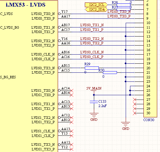

Hey people! I am in trouble trying to connect a custom LVDS display made by SAMSUNG to imx53qsb on the J9 (LVDS) connector (LCD Model: LT101NT02):
Here is my steps:
- Configuring a WSVGA resolution on mx53_loco.c as (watch the last entry of the array):

So both resolutions are IDENTICAL (I suppose), (note the RGB666 and LVDS666 on the interface_pix_format field...). then recompile the kernel with:
./ltib -p kernel -m scbuild
then changed the cmdline options in the bootloader as:
console=ttymxc0,115200 video=mxcdi0fb:LVDS666,WSVGA di0_primary video=mxcdi1fb:RGB666,WSVGA video=mxcdi2fb:RGB666,WSVGA root=/dev/nfs ip=192.168.143.173 nfsroot=192.168.143.6:/tftpboot/nfs-IMX53
,v3,tcp noinitrd
So the connector J9 (LVDS0 == DI0?) should have valid timings for a such display
Plug the cable on the J9 connector using 3 channels LVDS plus PWM for contrast and LCD_BLT_EN Lines connected tothe LVDS Panel pins named: PWM and LCD_BL.
Powering the backlight VLED unit with the correct Voltage using a Voltage Generator with 2A of MAX CURRENT.
But I do not see anything on the screen. Nothing.

xiachunquan
Alan Levy said:
LVDS only supports 18-bit colour (RGB666).
7,103 Views

AlanLevy
7,103 Views
