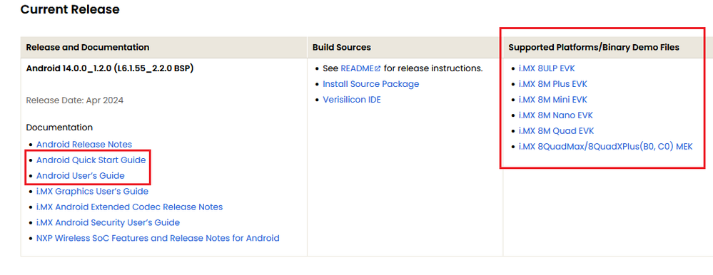

We want to bring up Android on iMx8QuadMax Evaluation board.
Can you please share the user guide or Manual along with BSP images.

Thanks for link for Quick Reference Guide and User Guide,
We are trying to flashing images using UUU utility to SD Card on Ubuntu 23.10 system
we are facing error screen shot is attached,
We are using below command
             sudo ./uuu_imx_android_flash.sh -f imx8mm -a -e
We want to know the command to flash the images(For Linux) on SD Card
             sudo ./uuu_imx_android_flash.sh -f imx8mm -a -e -t sd (we are facing the same error)

your original question is imx8qm, now you use imx8mm? what board do you test indeed? do you use prebuilt images or your own built images?

Sorry for the confusion, we are using the iMx8 QuadMax only, We were able to flash Android 14 and its booting perfectly, Thanks for Support.
Now We want to build the Android Source code for Automotive, Can you please suggest the steps we should follow.
