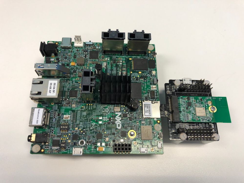

I'm trying to get a Murata 1MW EVK module to work with a i.MX8MQ EVK.
So far, I've compiled a Yocto using the scripts provided by Murata at https://github.com/murata-wireless/meta-murata-wireless ; I've configured it as follow :
Release Type: Developer (When using "Stable", the generated tag does not exists on the github repository...)
Processor: i.MX
fmac version: manda (recommended)
i.MX Yocto Release: imx-rocko-mini-manda
Target: imx8mqevk
I then proceeded to flash a SD card with the generated "*.sdcard" file and successfully booted my i.MX8MQ evaluation kit. At this point, I would expect to see a wireless interface associated to the on-board 1CQ module.
Now this is where it gets tricky :
  • I don't have any wireless interface showing when using "ifconfig", "ip addr" or "iw list";
  • I cannot see anything related to fmac module being loaded by the kernel during boot;
  • I can manually load these modules using "modprobe brcmutil" and "modprobe brcmfmac", but still no wireless interface shows up;
  • I've tried to load different FDT from the u-boot command line ("fsl-imx8mq-evk.dtb", "fsl-imx8mq-evk-root.dtb" and "fsl-imx8mq-evk-pcie1-m2.dtb") with no luck.
Even if I actually saw a wireless interface, it is not my final objective. I would still need to :
  • Flash the content of the SD card to the eMMC (to free up the microSD connector);
  • Connect my 1MW module to the microSD using the "Murata i.MX InterConnect V1" and a SD-to-MicroSD adapter;
  • Connect the remaining WL_HOST_WAKE, BT_REG_ON and WL_REG_ON cable somewhere on the board (where?!);
  • Probably rework/patch the FDT used by the i.MX8 family;
  • Something else?
Could you help me sort my problem out?

After a lot of trial and error, I managed to get it to work. Hopefully this will help someone with the same problem.
Step 0: Free up the micro-SD port
Flash a Linux image to eMMC using uuu tools provided by NXP.
Step 1: Hardware requirements
Use 'Murata i.MX InterConnect V1'; connect 'BT_REG_ON' & 'WL_HOST_WAKE' to 'GND' and 'WL_REG_ON' to 'VIO_IN'. Leave jumper on 3.3V mode.
Use micro-SD to SD adapter and connect the whole thing together :
i.MX8MQ EVK micro-SD port <== micro-SD to SD adapter <== Interconnect V1 <== Murata 1MW EVK
Step 2: Recompile Linux/FDT/fmac
I used the following command to clone the linux kernel :
git clone https://source.codeaurora.org/external/imx/linux-imx/ -b rel_imx_4.9.51_8mq_ga --depth 1
I used the following command to clone Murata's fmac :
git clone https://github.com/murata-wireless/cyw-fmac.git -b cyw-fmac-imx-morty-manda_r1.0 --depth 1
Link point to a gist containing :
Step 3: Install the changes
The newly installed files should be :
  • /boot/fsl-imx8mq-evk.dtb
  • /boot/Image
  • /lib/modules/<kernel name>/<list of modules-related files>
  • /lib/modules/<kernel name>/kernel/<list of modules>
  • /lib/modules/<kernel name>/updates/<list of backports modules>
  • /lib/firmware/brcm/brcmfmac43455-sdio.txt
  • /lib/firmware/brcm/brcmfmac43455-sdio.bin
  • /lib/firmware/brcm/brcmfmac43455-sdio.clmblob
The firmware files should be changed to match the module that is connected. They are available on the Murata Github. Don't forget to read the README files!
Step 4 (optional): Change u-boot environment
I called my new FDT file 'fsl-imx8mq-evk-btwifi.dtb' to match naming convention used by NXP.
It can also be useful in case of kernel panic with the new FDT : switching to the old one is easy.
During the boot process, press <enter> to change u-Boot environment variable 'fdt_file' value if needed : 'setenv fdt_file fsl-imx8mq-evk-btwifi.dtb'.
Using the 'saveenv' command can be desired in order to avoid this step at every reboot.
To go back to the default config, use 'setenv fdt_file fsl-imx8mq-evk.dtb; saveenv'.
Step 5: Boot the beast!
Link to a dmesg from a successful boot. mmc1 initialization, fmac driver automatic loading and firmware information should be displayed in it.
After login in, the command 'ip addr' should display a new wireless interface called 'wlan0'. I've managed to connect it in STA mode and to create an AP (a bit more work, since the binaries are not available by default).
If you have a question, feel free to ask, I'll try to help if I can.
  • /boot/Image

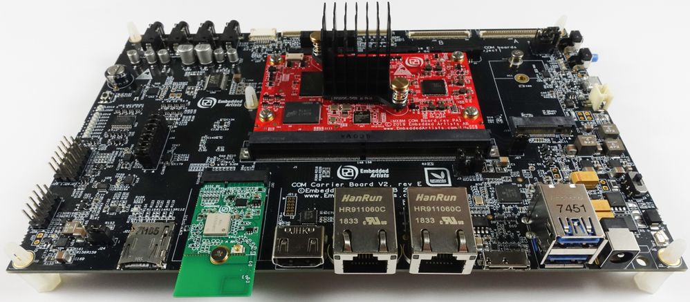

bill_chen1
Hi Theo, thanks for sharing the steps for making 1MW work on NXP's imx8mqevk. I noted that you are using Murata's old adapter. Murata has a new uSD-M.2 adapter now. This adapter works with Embedded Artists'(EA) M.2 interfaced EVBs. So for your application, you just need to get an uSD-M.2 adapter, put one EA's type 1MW EVB there, plug in the uSD-M.2 adapter on your imx8mqevk, then your hardware part is done. The picture for this setting is as follows:
Here is the link to the uSD-M.2 Adapter.
Here is the link to EA's M.2 EVB.
There is an even easier solution out there, which is EA's evaluation kits. With EA's kit, no adapter is needed to evaluate those M.2 EVBs mentioned above. You can also try different processors with this platform. The following picture shows the setup of EA's EVK. For more detail, please refer to the link here.
