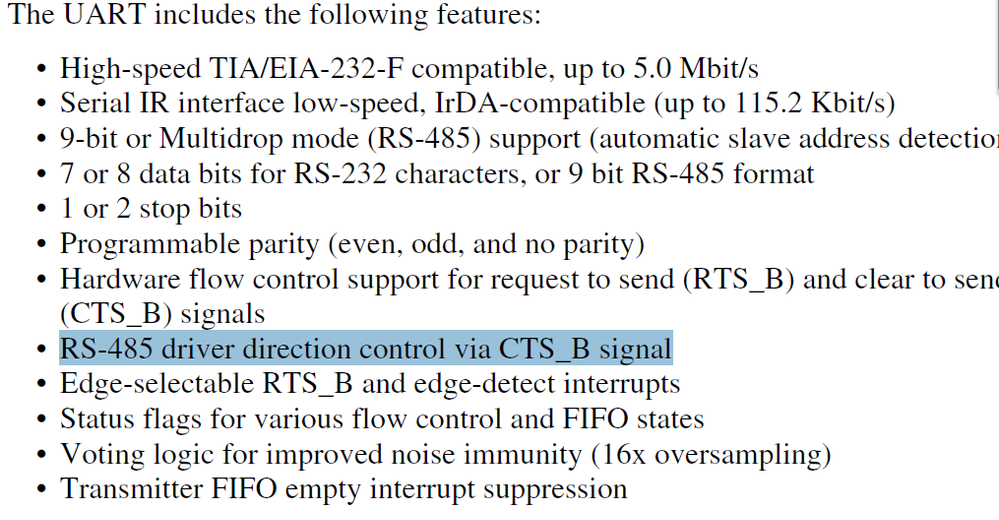

Hello Théophile,
     CTS_B pin should be used to control Rec or Send direction, not RTS_B. See reference manual, please!
Have a nice day!
TIC Weidong sun
2,124 Views
théophileblard
I read the manual, not deep enough obiously.
Anyway it's a bit disturbing that these lines :
rs485-rts-active-high;
rs485-rts-delay = <1 1>;
are in fact controlling the CTS pin.
I hope no one will make the same mistake.
