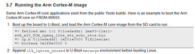

danielchen
There is one 10-pin connector P12 is provided on the board to support I2C, CAN and ADC connections. The developers can use the port for some specific application development.
P11 is provided on the FRDM-IMX93 board to support i2s, uart, i2c and GPIO connections.
In section 3.7 of UG10195 describes how to run the ARM cortex-M image.
Please refer to UM12181 FRDM-IMX93 Board User Manual for more details
https://docs.nxp.com/bundle/UM12181/page/topics/frdm-imx93_overview.html
