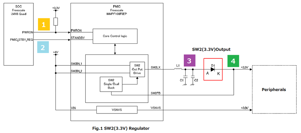

Now we are observing VDDs of our i.MX6Q custom board.
Just after shutdown command issued from console but PMIC VIN still kept alive,
we expected all SW regulators  fell to 0V but SW2 kept 1.4Vdc without any PWM/PFM switching noise.
(SW1,3,4=0V, SW2=1.4V, SWBST=0.7V)
Have ever someone heard same curious phenomenon? Is it correct behavior?
We knew SW2LX(MMPF0100F0 pin22) connected to GEN_3V3(NVCC_LCD/EIM/GPIO/SD/NAND/JTAG)
but current direction seems from PMIC to NVCCs.
Can anyone help us?

  Normally PMIC will not have this issue, this 1.4Vdc may be some leakage from other rails,
you need to check the all the nets connected to SW2.

Dear Yuri
We checked the current direction with additional diode as following.
Our result seems not leakage but SW2 output.  Please see attached waveform-B.
Is there any idea to kill SW2 during shutdown?
It doesn't matter STANDBY assert or not.
Thank you for your help.
1,463 Views
Yuri
   To check if we have a leakage effect (or strong voltage),
please try to pull down SW2 output via 50 - 100 Ohm resistor
during short time after power down.
Yuri.

  it may be some kind of leakage in the case. Is it possible to look at the
schematic. You may create request to provide it.
