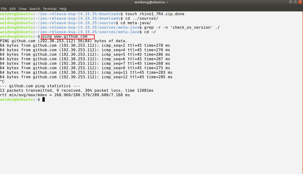

Hi, Raana,
     The problem you encountered is obviously caused by the network failure, because it seems that your PC cannot access the Internet.
     >>I think this may be because of my network. But, I don't know how to prove and resolve that.
 You have many ways to verify that your PC can access the Internet. Using a browser, you can visit any web address to check whether there is a problem with your network. Even Ping www.github.com on the command line can verify the network.

weidong_sun
Hi Raana,
    I don't know what's wrong with your network. No user has ever encountered problems with repo sync and repo init. There are many software packages that need to be downloaded from github.com. If your network problem is not solved, you cannot download Linux BSP.
I just compiled l4.19.35_1.1.0 BSP on Ubuntu 18.04 LTS. This is the fifth time I compiled it. I have never had repo init and repo sync problems.
