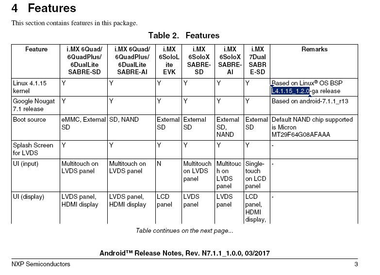

If the Android 7.1.1 is not supposed to support an EPD display for the i.MX7D Sabre shouldn't the section in the Android User's Guide that indicates the procedure for using the epdc images be removed? The noted epdc image files are present on the distributed demo images zip and get built by the build procedure.
This implies that it should have worked out of the box, where your indication is that this capability (EPDC support) does not exist.

tomoke
That unfortunately only deals with Linux, which was known to work, rather than the Android 7.1.1/2 that I am trying now.
Other forum entries have suggested that it is not supported, but used terms like an alpha image.
The prevailing android user's guide indicates how to build the SD-Card, with the 3 epdc specific versions of files, which would suggest that it should work, so the status of the EPDC Android seems to be contradictory. It would be good to have a definitive indication whether it really won't work out-of-the-box and needs more work, and if so, why the section is not pulled out of the guides, or at least qualified.
