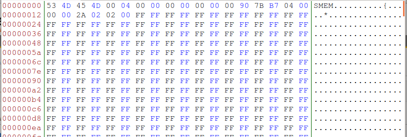

3. I suspect your system is not able to boot because of wrong image format programmed to the SPI flash (SPI config block, u-boot...).

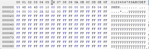

Here is an example of how your flash content should look like at offset 0:
On our system (also i.MX28 EVK) which should be similar to yours:
- At offset, we have the SPI config block,
- At offset 0x1000, you should be able to find your u-boot,
- At offset 0x50000, you should find your Linux Kernel.
Please dump your flash content after you program the boot images and make sure that you have the right image formats in there.

     3.My spansion flash content doesn't looks like the example that you shared here. At offset zero , I am writing linux boot stream image(imx28_ivt_linux.sb).
         My aim is to store linux boot stream image and rootfs.jffs2 on SPI flash.( not using uboot boot stream image (imx28_ivt_uboot.sb)).
       I don't have spi config block. In my linux BSP code, I couldn't found it.

Yes, please refer to the slide deck I sent you in my previous post. There, you will find useful information about how to configure your system to make it boot out of SPI.
I think you must have the SPI config block at the very beginning of your flash since that's the first area that's being read by the ROM code in order to do the init first of your SPI (needed for code shadowing: SPI --> RAM). If this block is not there, then this might explain your issue.
I think you can reuse the SPI config block content I included in my previous post and give it a try.
Maybe you're missing the Boot setup in your BSP and you just need to tell it that you want to build it for a SPI boot. Once you configure it the right way, it should output the correct image format to be flashed to the SPI.

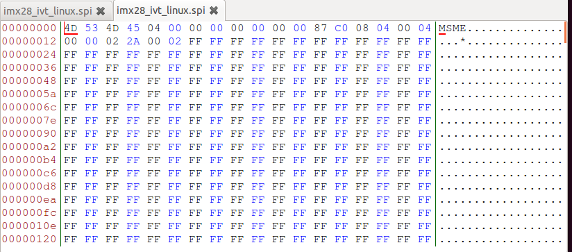

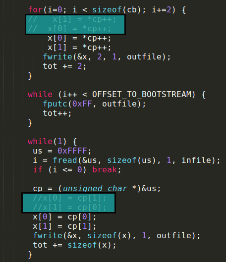

     The necessary changes has been applied to my bootlet code to build imx28_ivt_linux.spi.
     But the hex dump of this file differs from the example that you have shared here. The file signature mismatches.  The hex content looks like that it is swapped.
     I checked the spi-build.c code and corrected it.
Now the hex dump looks similar to your example. But still I am getting that ROM error code H0x80501003 - The file signature or file version is incorrect.

BacemDaassi
Hello Pt A R,
I'm pretty sure that you're having an endianess issue here.
Please refer to the iMX28 reference manuel which you can get from here:
http://cache.freescale.com/files/dsp/doc/ref_manual/MCIMX28RM.pdf?fasp=1&WT_TYPE=Reference%20Manuals...
On page 1028 of the RM, you can find the format of the config block.
From the binary image you sent above, I can see that the BootStartAddr is 0x00000400. Did you write your u-boot to this address?
Could you please try to use the config block I included in my other post as it is and give it a try?

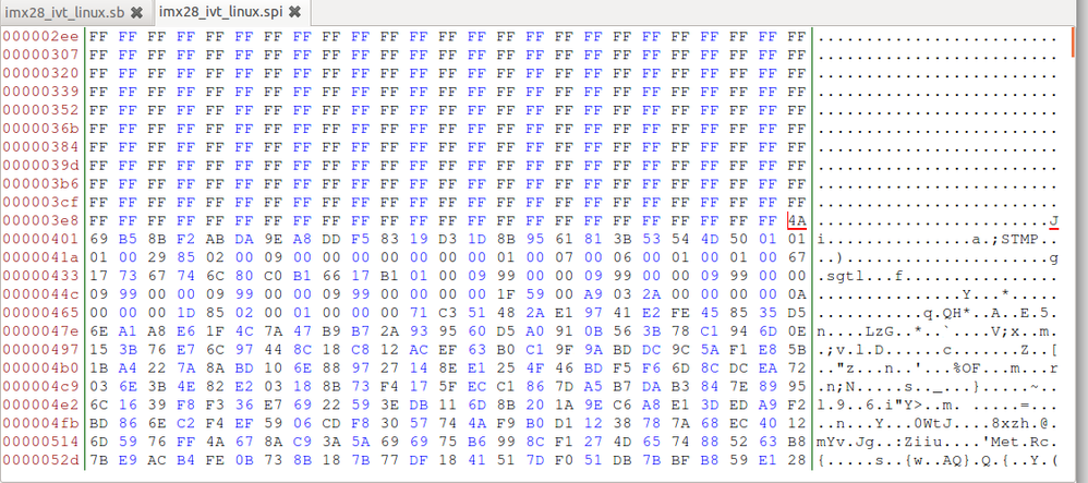

Hi BacemDaassi,
Thank you.
In my project, we are using linux boot stream image and rootfs only. So that we have written imx28_ivt_linux.sb on 0x400.
I didn't see any config block.You had shared its hex dump only.

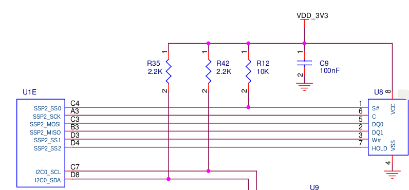

1. Is it mandatory to populate R320, R321,R322 and C178?
In MCIMX28EVK, I have successfully booted up from SPI (Numonyx N25Q128).The development board doesn't populate with these resistors and capacitor.
But in the custom board I am not able to boot from SPI( SPANSION S25FL256S_64K).
2.Do I have to use those resistors and capacitors for my custom board to boot up from SPI?
The figure shows the SPI connection in the custom board.
I am able to read and write on SPI flash.I have placed uImage and rootfs on SPI flash.Then successfully booted from SD card and read uImage from SPI and logged in.
iMX28 U-Boot > setenv bootargs_spi 'setenv bootargs root=/dev/mtdblock1 rootwait rw rootfstype=jffs2'
iMX28 U-Boot > setenv bootcmd_spi 'run bootargs_spi;sf probe 0;sf read 0x42000000 0x0 0x300000;bootm'
iMX28 U-Boot > run bootcmd_spi
So I think there is no problem in erase,write and read.
3.Still it doesn't boot from SPI. Keep on getting that same error code H0x80501003.

lonsn
I meet with same issue as you. My problem is the HOLD pin of spi flash is connected to CPU directly without pull up. Then the spi flash is hold during power on. I fixed it by adding a pull up resistor in HOLD pin.

BacemDaassi
Hello Pt A R,
Did I understand correctly that you're able to boot from Nymonyx part but from Spansion's part?
On the i.MX28 EVK, the R320, R321 and R322 are pull-ups on WP#, CS# and HOLD#. These are not populated by default and need to be populated since these signals should not be left floating. C178 should be populated as well.
To enable Quad I/O on our board here, we had even to solder two additional wires to DQ2 and DQ3 (Hold# and WP#) to enable Quad I/O. Without those wires, you will not be able to use Quad I/O at all.
Thanks!
