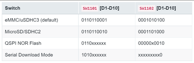

Hi @edwardtyrrell,
the bootswitches are set correctly (I'm using a custom design, but the boot_cfg is set accordingly). When I try to boot from the eMMC I get a delay before the board switches to serial download mode, so I guess I at least wrote something to the eMMC, but well, nothing bootable.

Hi @edwardtyrrell
First of all, thank you for your constructive input, our custom board is now booting as intended!
For anyone who might stumble upon this thread later in search for a similar solution I summarize our steps: As hinted by Edward our boot-config (DIP-switches) might be faulted, and/or the recovery button might not work as intended. For clarification, our board uses the Signals from the two bootswitches and the recovery-button to determine some of the boot_config signals and the bootmode, they are not directly send to the iMX. Via U-Boot and the gpio-interface I checked the ingoing signals boot_cfg[15:0], and there I found the missing straw. As only some of the 16 bits are set by the switches, others are set directly by pulling the pins up (pulling down is not necessary, done internally). I then traced the wrongly set bits to a set of resistors that were planned as not to be placed in the schematic (still in development), but when the board went into a hardware-modification, the resistors where placed and soldered on (wrong instructions for the modification), resulting in the wrong boot configuration. By removing the resistors the boot configuration was fixed and the board is now booting as intended.
I hope this will help others in the future facing similar problems, thanks again!

11,408 次查看
JorgeCas
Dear Dominik Poggel,
First of all, I need a little more information.
Are you using a custom board or the EVK board?
What is it your current UUU version? (Try to update to the last available version)
Could you please provide me the command to flash the board and .auto file?
Is it a custom image or NXP's precompiled image?
If is not booting from eMMC and goes to download mode after some time, this could by caused because is not detecting an eMMC device to boot or has not the correct value on the boot switches.
Also please double check the values on boot switches (the next figure is for i.MX 8M Mini EVKB):
Best regards.
