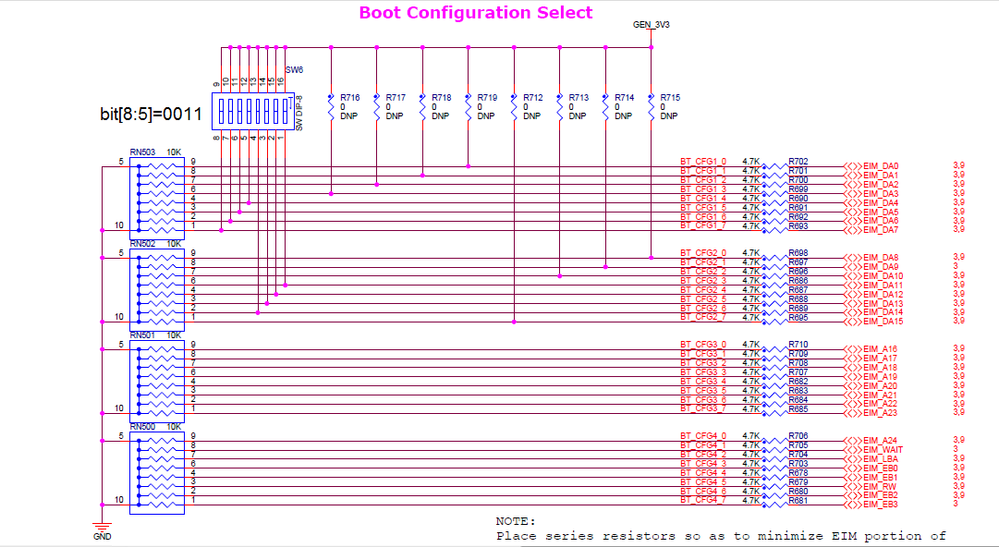

I am wondering if anyone already try to boot from SPI-NOR on MX6 Duallite SABRE SDP for smart devices platform ?! I guess that SW6 DIP configuration should be D5 and D6 to "1" and others to "0"
But nothing happen for me ?! Where can I find a good u-boot binary to flash ?!

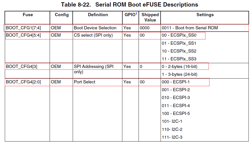

  Basically such boot configuration may be provided on the MX6 SDP, but the problem
arises to pin multiplexing : for example CSPI1_clk is connected to i.MX6
KEY_COL0 pin, and according to Table 8-25 (SPI IOMUX Pin Configuration) of the
RM, such pin multiplexing (ECSPI-1) is not supported for SPI NOR  boot.
   The problem is stated in Table 7 (Known Issues and Workarounds) of
"i.MX_6Dual6Quad_Sabre-SD_Linux_Release_Notes.pdf" :
"SPI NOR boot is not supported by Smart Device Board.
Current SD board uses KEY relative PINs as SPI interface. However, this set of
PINs are not supported by ROM. Therefore, SPI NOR boot is not supported by Smart
Device Board."
In general one can test it on Sabre-AI, where it is supported.

weidong_sun
Hello,aurelien,
  ECSPI booting should be supported on SDP board.
(1)Configuration that ROM code requires
(2)Configurations On board
Yes, right. bit6 & bit 5 are both 1. System can be booted via eCPSI1 Port.
(3)Maybe you should adjust u-boot .
On Sabre AI board, Booting from SPI NOR is supported, you can refer to u-boot for AI board, and adjust Code for SDP. then use MFG Tool burn u-boot into SPI NOR flash.
Would you like to try ?
Weidong

Not sure if this helps but I have successfully booted from SPI-NOR using the SABRE-SDB board but I had
to connect a separate device to the board so that it boots from ECSPI5.  For the device I used (AT25DF321)
I had to set BOOT_CFG4[3] to 1 and BOOT_CFG4[2:0] to 100.
