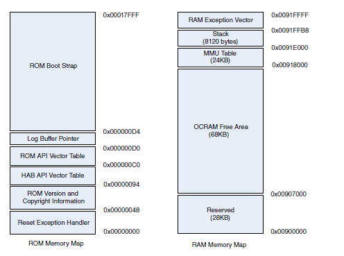

You need to check some definition in the head file.
The .text should not lower than the load address.
And please make sure only leave uart and its pad settings.
remove all the other pad settings.
#define CONFIG_LOADADDR 0x00907000
#define CONFIG_SYS_TEXT_BASE 0x00908000
#define CONFIG_NR_DRAM_BANKS  1
#define PHYS_SDRAM   0x908000
#define PHYS_SDRAM_SIZE   SZ_128K
also please make sure the uboot is not bigger than the size for OCRAM Free Area(68K)

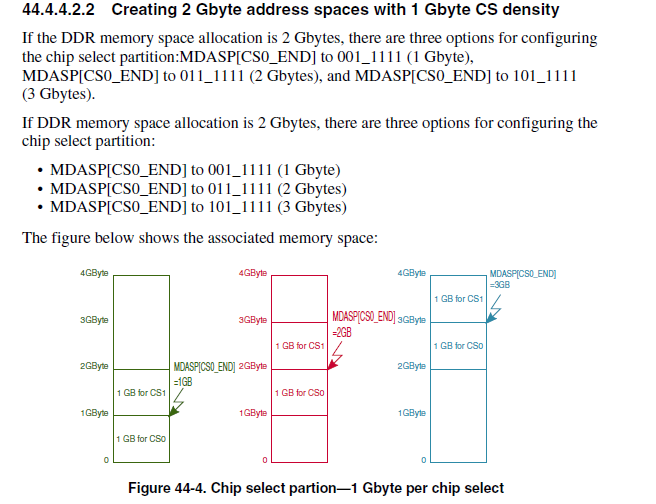

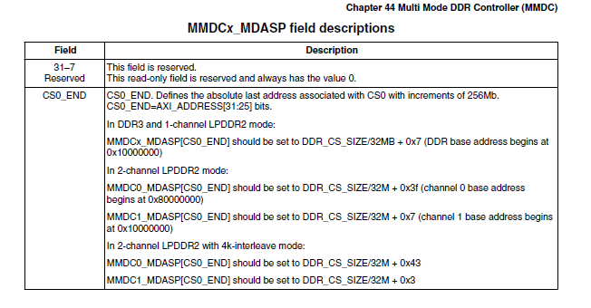

       I have test the DDR by mtest(mem_test_alt), our DDR is 1GB,sou the addr is 0x1000 0000 - 0x3fff ffff, and the test is similar to the uboot load in DDR, I load uboot in IRAM,but still can not test the whole DDR,why?Could you help me ~
2,572 Views
BiyongSUN
So far, the information from you is not enough, such as type of DDR. DDR3 or LPDDR2.
The memory address space depends on the hardware design.
DDR stress test reads from the script and configure that. the script is generated by aid. you don't need to worry about that.
But in the uboot, you need to change the code for that.
Chapter 44
Multi Mode DDR Controller (MMDC)
44.4.4 MMDC Address Space
44.4.4.1 Address decoding
MDASP[CS0_END]
BTW, commonly, the mtest is not stronger that the patterns in the DDR stress test.
If wants to give DDR more pressue, you need to run the linux then occupy all the cpu bandwidth, run gpu and vpu together.
That way, you may see whether like ripple is there to influence the performance.
