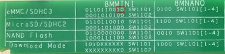

Hi PramodKumar ,
We have performed the below steps to flash image in emmc using UUU:
  • Set the Boot switch for serial download mode to flash in emmc:  SW1101 (10XXXXXX) and SW1102 (00101010).
  • run the script of uuu using below command.
    • sudo ./uuu ~/L4.19.35_1.1.0_images_MX8MMEVK.zip   (path of your zip file:~/L4.19.35_1.1.0_images_MX8MMEVK.zip)
  • change the Boot switch after flashing is done from uuu.  SW1101 (01110010) and SW1102 (00101010).
We are able to flash and boot successfully. Are you using the same steps and switch configurations as mentioned above?
Make sure you have installed all the packages required for uuu and can you please share the logs of uuu using -v (verbose) with it?
  •  sudo ./uuu -v ~/L4.19.35_1.1.0_images_MX8MMEVK.zip

PramodKumar
Weare using the download mode with emmc , as per the below image :=

Our switch settings are of 10 pins for both the switches in evolution kit .
