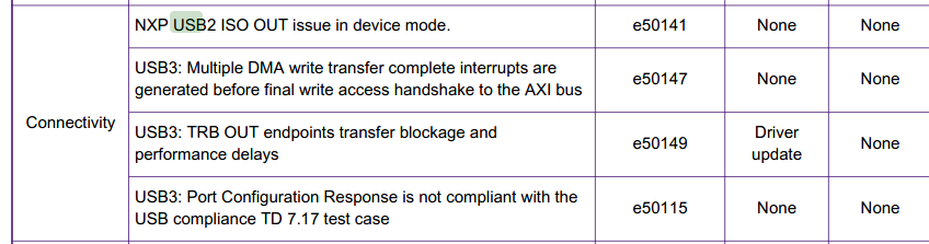

  We are working with IMX8X based device , where the device will act as a webcam and using the USB3.0 port. The device is now getting detected as a  super speed uvc gadget device. We have the requirement of streaming 720p video at 30 fps (422Mbps), But now we are able to achieve only 8fps (112 Mbps). There is no additional delay in video capture or processing happen since  we are using a  file source (single frame) and push the frames when we receive the callback.
   What is the maximum supported speed by USB3.0 port of IMX8X in device mode. And How can we improve the  current performance?

what chip revision and bsp used in the case, recommended  latest c0 revision
as described in AN12770
i.MX 8X C0 Migration Guide Migrating from i.MX 8X B0 to i.MX 8X C0
and official nxp linux releases from source.codeaurora.org/external/imx/linux-imx  repository

   We are currently  using the B0 revision chip sets, with linux version - 4.14.98.usb3.png
Which one  would affect in  our case  in getting some  good numbers on B0 usb device mode.
And what is current rough numbers of USB 3.0 iso speed in device mode in revision B0 hardware.

recommended  to use latest c0 revision as described in AN12770
 For production only c0 parts should be used, as it is final revision with
production quality.
