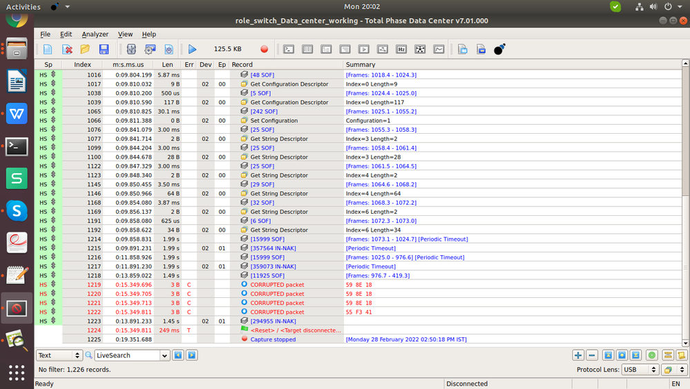

Hi NXP team,
When we are changing the role of the imx8 from host to gadget we are losing the connection which could be expected but its not reattaching (enumerating) the connected mobile device
In case of CarPlay we are changing the role of the imx8 from host to gadget  and sending role switch custom command to Apple phone to reverse its role as Host but we could observe its disconnected. Possible cause of disconnection occurs because of NACK. Apart from this, supplying the power from imx8 to the Apple phones irrespective of the role is also something we are facing issue with -
Kindly help on this issue. Also, provide role switch working binary if it is available for imx8qxp/qm mek.
Thanks a lot in advance.
I have added the below details with respective to usb roleswitch application which we have tested.
Steps followed in Roleswitch test:
   1. Keep iPhone  connected
   2. Send roleswitch command to iphone
   3. Do HU roleswitch
   4. Verify iPodout0 node is created
   5. Disconnect and verify switch back to host mode

Note: Attached the usb analyzer log captured during roleswitch operation.

Hi @Rita_Wang , Not able to attach the log file. Attached it screenshot. Please check it.
2,335 Views
afridi20
Screenshot from 2022-02-28 20-01-59(1)(1).pngScreenshot from 2022-02-28 20-02-23(1).png
