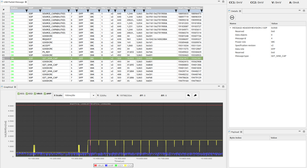

Hello, I'm experiencing some serious issues with following configuration:
- imx8mm-evk
Cypress CY4500 EZ-PD
- Apple Hub A2119
- Raspberry Pi USBC power supply 5V/3A or Dell Laptop USBC power supply (5V-1A 20V-6.5A)
What I'm trying to do is provide supply through USBC hub to the evk board on USB2 primary supply port J302
The problem I see is that the board never boots into kernel and remains in u-boot in loop forever. It seems to me that PTN5110NHQZ or its u-boot driver is not working properly since is not responding to GET_SINK_CAP pd message from the hub with real values but only with GOODCRC. Other messages before perform fine so it seems some software support is already present in u-boot see image below:

So the problem is that Apple hub is failing in detecting the current capabilities of the Raspberry Pi PSU on the hub own supply port. So that what's happening:
apple hub: Source_caps PDO Fixed 5V Max 100mA
evk: Request PDO 1 (5V) operating current 100mA and 1800mA Max with Cap Mismatch bit = 1 (means negotiation failure)
apple hub: accept & ps_rdy
apple hub: sink_caps ?
evk: answer crc okay but never respond with own sink caps
Explanation: I think tcpm driver inside u-boot on evk is going in a particular state that is marking the negotiation as invalid. The Apple hub is
not capable of sourcing the required current and the driver goes in a cycle where is answering only with crc okay messages. During the whole negotiation the evk never exceed 500mA current as required by PD specification.
Pending issues: I don't know if entering such a loop is good/bad neither if is specification compliant. Any clue?
