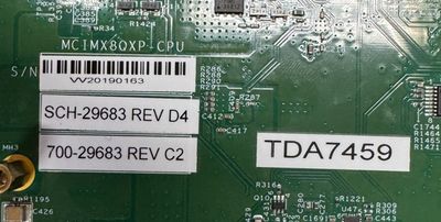

I purchased an i.MX 8QuadXPlus MEK
Tag information on the platform:
TDA7459
SCH-29683 REV D4
700-29683 REV C2

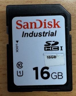

I use a SanDisk SD card Class 10 16GB (this SD card was given as a gift when I purchased this platform, and the default uboot version in the SD card is U-Boot SPL 2018.03-4.14.98-2.3.0+g0e207921e9).
I boot the system through the SD card.

   Platform information
   - i.MX 8QuadXPlus MEK
   - Hardware version photo

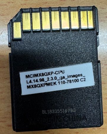

   - SD Card is "SanDisk SD card Class 10 16GB"
     This SD card was given as a gift when I purchased this platform, and the default uboot version in the SD card is U-Boot SPL 2018.03-4.14.98-2.3.0+g0e207921e9.
Below is a photo of the SD card
