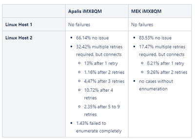

In the meantime, we did automated tests for the recovery mode. With the test setup, we can power cycle the MEK board or our own computer module based on the i.MX 8QM and test how many attempts it takes for enumerating the USB in the serial loader. I did this test with two different Linux hosts. For each combination, I did around 3000 power cycles. Here an overview of the test results:
The interesting part is that with our own hardware, only 66% of the time, the enumeration is successful on the first attempt, while on the MEK it is 83%. On the MEK, a maximum of two retries is required for a successful enumeration. The connection can always be established. On our own board, much more retries are required, and in 1.4% of the cases, the enumeration fails completely.
Can you please help us understand why we have a different success rate? Do you have any idea what could cause the different behavior? Could it be related to a difference in the PMIC power-up sequence timing?
You mentioned that there are CRC errors that lead to a failing enumeration. Do you have a further background on this? Why is the CRC failing?
We are really concerned about the 1.4% of the cases the enumeration is completely failing. This will cause massive issues during production testing if we cannot rely on a USB enumeration in serial loader mode.
Thank you in advance for your help.

peterlischer
Senior Contributor I
Hi @igorpadykov
We changed the Linux kernel on the host PC and run the automated test again for several thousand cycles. The results are quite interesting:
The success rate for enumerating the USB the first time increased dramatically on the MEK and our own hardware. On the MEK, the enumeration was successful at 99.46% of the time. We had only 21 times out of more than 3000 cycles that it required one retry. It now never needed more than one retry for enumerating the MEK board.
While our own hardware also had an increased success rate of enumerating the USB without a retry, the cases in which it was not able to enumerate at all massively increased from 1.43% to 7.37%. This is quite alarming. Do you have an idea why the behavior of our own hardware could be different? Could it be a difference in the voltage rail power-up sequence or the routing of the USB signals?
Please find attached some examples of dmesg outputs of the host PC. These are the complete dmesg we get during a test cycle. We do not reboot the host PC during the tests. Therefore, sending the dmesg of the kernel boot does not make much sense. Please let me know if you would like to see different dmesg outputs.

peterlischer
Hi @igorpadykov
Since it was easier for the automated test setup, we have been using our own hardware as host computers.
  • Linux Host 1 (which works fine) is an Apalis iMX6Q. It is based on the i.MX 6Q SoC and runs the following OS:
    Linux apalis-imx6 4.1.44-2.7.4+gb1555bf #1 SMP Wed Oct 4 22:39:51 UTC 2017 armv7l GNU/Linux
  • Linux Host 2 (on which we saw the failures) is a Verdin iMX8M Plus. It is based on the i.MX 8M Plus Quad SoC and runs the following OS:
    Linux verdin-imx8mp 5.4.91-06394-g82e97870feb6-dirty #3 SMP PREEMPT Fri Apr 30 11:42:05 CEST 2021 aarch64 aarch64 aarch64 GNU/Linux
We have seen the same issues also with two laptop PC of our software developers. However, since they need their PC for work, we did not do automated test cycles on these machines:
