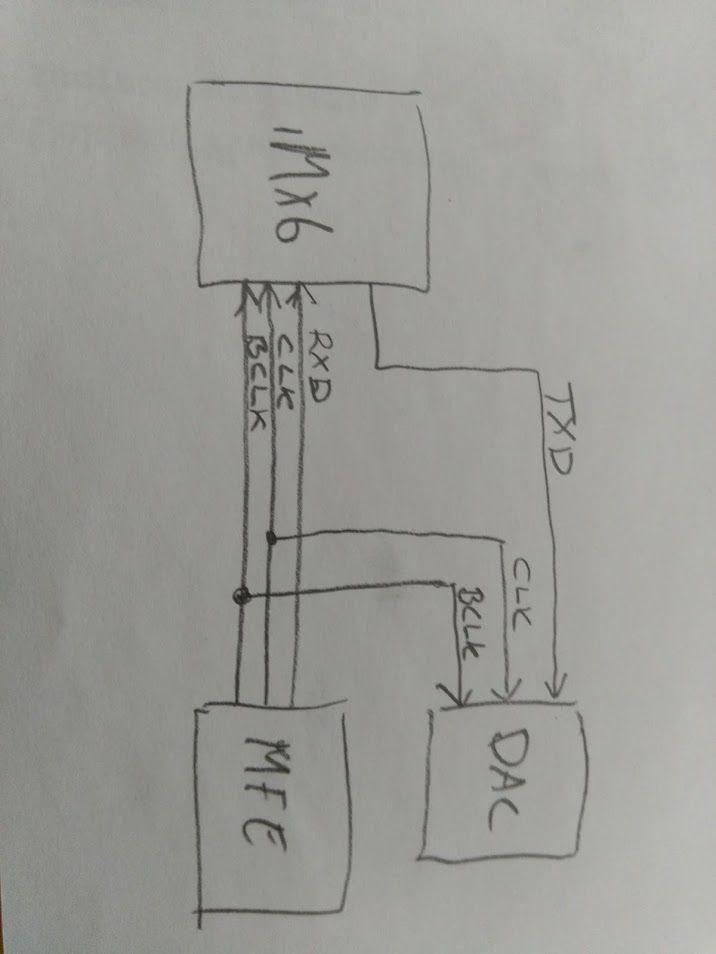

I don't have schematic at hand as this was hand propped as demo. But I'll try to walk you trough this:
1. Codec(cx2092x) is I2S master and supplies blck & lrclk for both devices.
2. Connections in imx6 side. This is what our HW guy told me:
   Bclk  -> gpio4_24
   lrclk   -> gpio4_23
   rxd     -> gpio4_27
   txd     -> gpio4_28
HOWEVER. We do not schematics for the variscite imx6ul var som. For example the varicite pin header places the sai1_tx_bclk to csi_data07 pin, however that doesn't match the corresponding register iomuxc_sw_mux_ctl_pad_csi_data07.

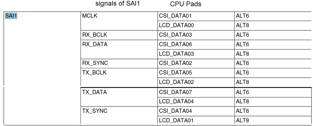

weidong_sun
Hi, Matti,
   Below is IOMUX PINs for SA1 of I.MX6ULL, if you don't have schematic, we all don't know which pins cpu have used for 2 CODECs, which cause we don't know how to configure IO multiplexing .
   So I doubt there is something wrong with IOMUX in dts for SAI1
Connections hardware engineer told you are not correct, she should told you pins name of I.MX6LL for SAI1 interface, then you will know to configure them in dts.
Have a nice day!
NXP TIC weidong sun

If you check those gpio pins, they actually match to correct cpu pad, but with different ALT function. He used the gpio name just to identify the pin name.
