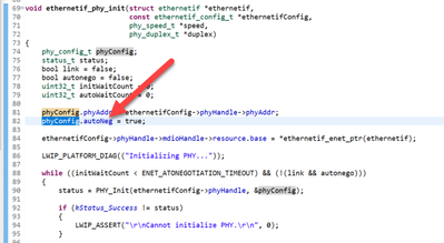

1) I want to turn off Auto-negotiation and run on a fixed speed. Is it possible?
-- Yes.
2) Is there any auto-negotiation flag that can be set for this in the code?
-- Yes, you can set the phyConfig.autoNeg to false to disable the auto-negotiation function.

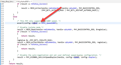

ranjay_shandilya
@jeremyzhou Thanks for the reply. After setting this to false, Ho do I set the fixed speed (say I wanna run at 10 Mbs).
